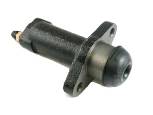

              Got under the car this morning and moved the boot and fluid came out so need to get a new slave cylinder. Did some Googling and have seen some described as long throw for the TR6 but needs a matching master cylinder" "We also have available a Long Throw version to be used with the .70 clutch master cylinder for an improved clutch pedal--just search our eBay store." Since the cylinder shares the same part number, is there an equivalent clutch master cylinder for the Stag? If so, can this long throw be used on the Stag?
              Also prices in the US are all over the place ranging from 16$ all the way up beyond $50 from non branded ones to branded ones. The $16 one is from a reputable seller here in USA

              It should be OK
              Sujit
                smaller bore longer travel
                  has anyone tried one of these with the standard master cylinder
                    I think they are meant to be used with standard masters.. The point is that the standard cylinder pumps out a certain volume of fluid, if the slave is smaller diameter then it will travel further. But.. the effort would go up.

                      I just ordered a regular one locally. Prices are all over the place for non branded ones verses branded ones. I just ordered a $16 one. The guys from BPNW sells quite a few of these and have been selling them for sometime.
